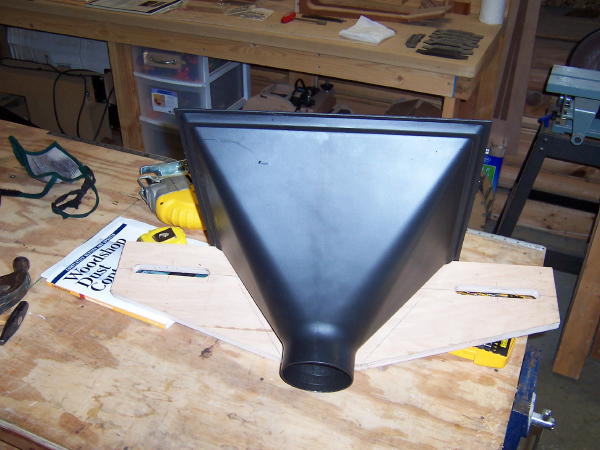

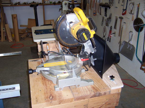

I'm installing a dust collector and thought you folks might like to see how I'm approaching collection at some of my machinery.

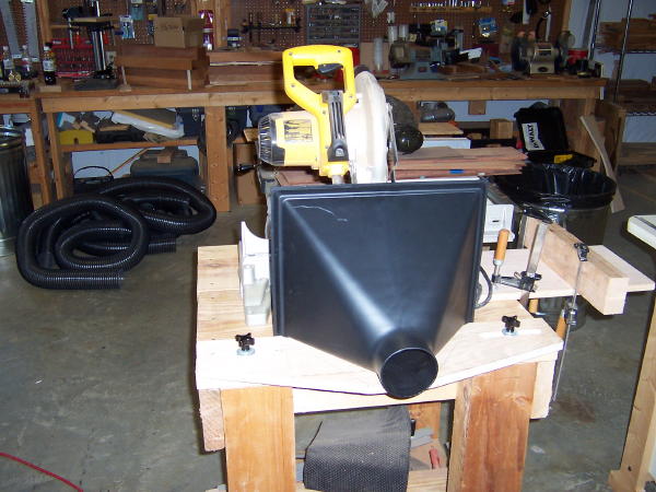

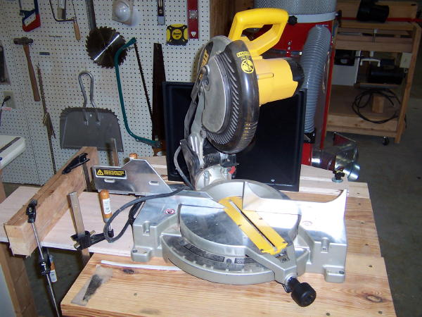

First is the miter saw. The hood can slide right and left far enough to keep in a useful position cutting 45's.

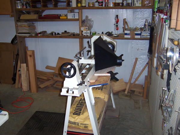

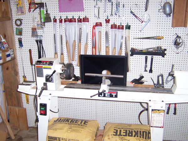

Then, probably doesn't qualify as a common lutherie tool, the lathe. I just attached a shelf on the back of the stand, mounted the hood on a piece of wood and can position it anywhere along the shelf and clamp in position.

Suck is right! I've got a Penn State single stage with a 1 micron canister. 2 Hp, 220v, 12" impeller. Supposedly pulls 1500 cfm. I had to run a 220v circuit to it and I want to thank Bruce for talking me through it. I'm going to try the trash can thing to make it a two stage collector at a couple of different points. Pics when it is all finished. Maybe tomorrow.

Hi, Serge. Those hoods came from woodworker's supply, I think. Most of the woodworking supply houses have them. These are the largest I could find, about 16" wide.

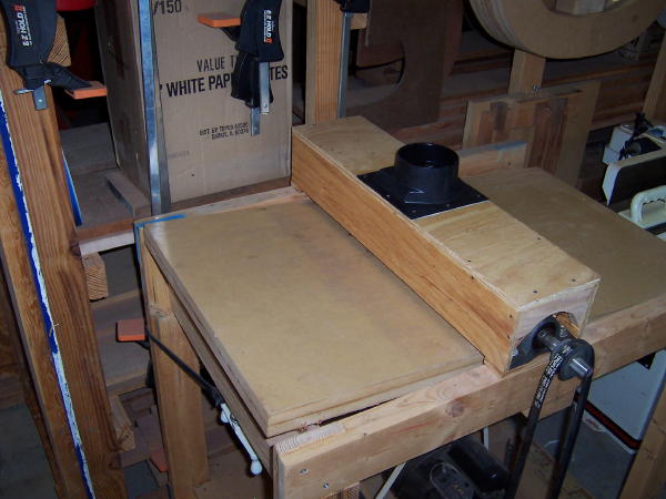

I'm currently trying to keep on of the massive amounts of waste that the pin router creates! I need to sort a big funnel like the one in the first post methinks.
